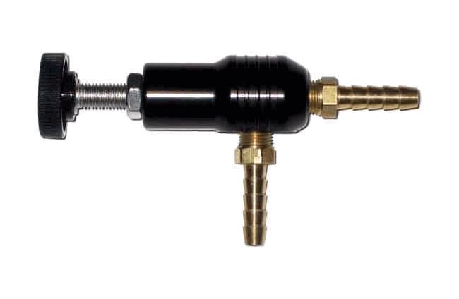

I do not know the generic mbc, but does it look like this?
2 things:
1st: Check all clambs and hoses, make sure everything is tight.
2nd: Go out to a long deserted side road, pull 3rd gear. If it does not make 22 psi or 1.5 bar, then turn it up SLOWLY until it does.
Hope that helps you out.
EDIT: Forgot to mention that is a Hallman ES MBC, I have the same one, and it works great.
