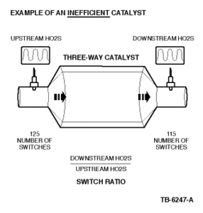

See pictures:
The effecient cat would be a stock cat. Note flow post cat. Slows down the air.
The ineffecient cat is what happens when we cut or use a hiflow cat.
The rear 02 sensors function is to measure air flow, when we have no restrictions to the flow (i.e. no cat) then it will cause a SES light.
See pictures:
yes, it has nothing to do with emissions...just tricks your o2 sensor because it spaces it a bit off of the pipe.
on the other hand, i dunno about passing emissions with your hi flow cat. i would just put your stock cat back on when you go to get tested.
