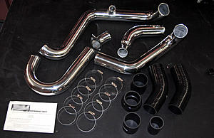

my vote is the rvm kit. I really like the way they transition out of the turbo quickly, minimizing the pressure drop accross the smaller portion of the i/c piping.
I personally dont own this kit, so I dont know how well it fits. I just like how it's made.
As other people said, this shouldnt be your first mod or 2 with regards to increasing power! However, it's your car & do as you please!
