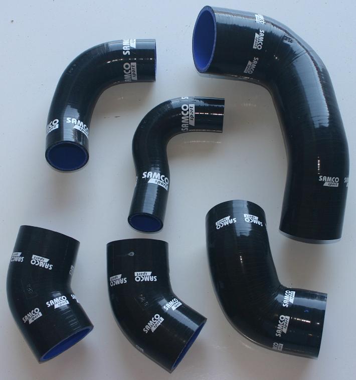

How do these compare to IC piping kits? Good or bad alternative?
i would say just as good as the helix , but the stock lower ic pipe still stays long.
Bump for more info. I was thinking about the samco hoses with stock fmic pipes instead of a full ic hard pipe kit.
