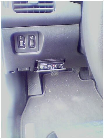

I'll keep you guys posted for sure. I mounted the BC in the little flipdown compartment to the lower left of the wheel, sweet spot for it. I need a little velcrow to hold it shut, the unit is real light.

theres a flip down compartmnet left of the wheel?
thats news to me. What about your warrenty stv? are you just chucking it away?

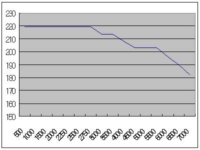

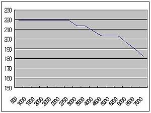

Nobody check the stock boost with boost gauge or BC?
The graph is my guess from EVO8's ECU data.
(It's a ECU's target peak boost. )
Y-axis: Boost (bar)
refer. : 220 -> 1.2 bar (17psi)
190 -> 0.9bar (13psi)
X-axis: RPM
Some body checked it, plz let me now.
