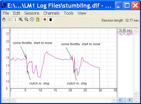

I had Shiv tune my Smart + Xede + XedeFlash in St. Louis recently; i have a bit of an issue with stalling under certain conditions though that I hope you guys can help me with.
Basically, when the engine is warmed up and I give it some gas and start to move; then quickly clutch-in and stop, the revs will drop too low - for example to 400 revs. In some cases it even stalls; particularly once it is fully warmed up.
I reduced the overlap of the cams a little to see if that helps; the same symptom persists. The car idles nicely otherwise particularly with the decreased overlap.
Here is a log of the AFRs where I did the sequence a cocuple of times in a row. The first time it just dipped too low, the second it eventually stalled. Note that the arrows I added are just "guesstimates" of where I did what - particularly the clutch in.
I turned up the idle screw to ~1000; that doesn't seem to cure it neither. I haven't changed the idle rev setting in the ECU yet though.
Mods are: Xede + Smart, XedeFlash, JDM MR DV, Jun 264 cams, TB exhaust + tubular o2, walbro 255. (So I am running the stock air intake + filter)
Could it be an issue with the LTFTs getting out of whack? (Is there a way to monitor those with the tactrix cable? Vacuum leak? Something else?

Ok, first checked the DV signal line isn't pinched; looked fine but I loosened it a little more - didn't resolve it.
Then I increased the ECU idle settings a bit, added some more timing down low - didn't resolve it yet neither (might try to tweak this some more to see if it helps).
I then put the stock plastic DV back; I can still get it to go too low/stall though.

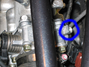

i would try raising the idle by screwing out the idle air-bleed screw. This screw's location is circled in the pic below. it's best to us a stubby standard or phillips screw driver.
Yeah, the ecu/i.a.c. will try to bring the idle down to its configured idle speed, but if you back this screw out, you'll be relying less on the iac to contrrol your idle, which may help you out.
give it a try, just remeber how much you back it out, so you can back to the way it was if necessary.

wot, how many turns per 100 rpm raised? is it better to raise idle the way you describe or by adjusting the throttle cable?

IMO it is better to simply raise the idle RPM targets in the ECU. Before I got ECUflash, I used to try to 'tune' my idle by adjusting the BISS, with very mixed results. Giving the ECU a higher RPM target to shoot for at idle has given me much better results.

^ agreed. Wasnt certain that you could set the idle speed with the xede.
knowing that now, i would increase your idle speed set point to ~950 +/- 50 rpm, but based on the fact that the the ecu is hunting or trying to achieve your idle speed in the situation described in your original post, i would still open the idle air bleed screw up some.
I dont know if you can alter the gain for how the iac responds within the xede.
