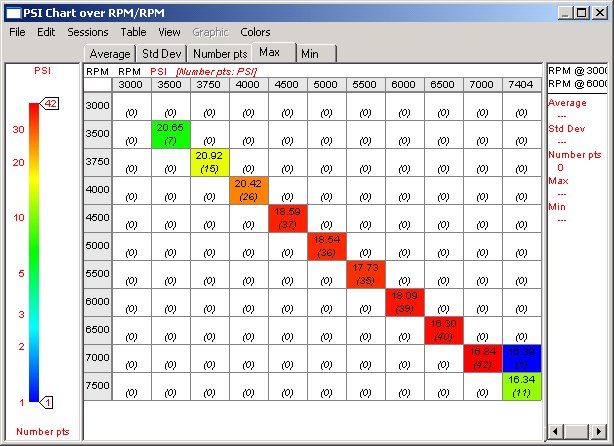

I know a lot of threads mention that your boost will go up when you switch to a TBE. On my car this has NOT been the case. I have been running w/o the Xede for the past week. I only have the panel drop-in and the TBE w/HFC. I also put the pill back in the hose. With the Xede I used to boost to 22 psi on pump gas. Now with the stock boost set-up I logged four runs and the boost hits a MAX of 20.9. That is less than 0.5 psi above what a stock 05 EVO max boost (20.5). I have no boost leaks since I have had no problems boosting with the Xede on.
I do not know if others have logged their boost to test this, but the talk of more boost with a TBE does not seen to work at least on my car.

It is not easy to tell from a boost guage how high you are boosting. It is going to be hard keeping an eye on the gauge while going WOT. Also, boost gauge tend to be inaccurate. I know mine was and it was a good Defi D gauge.
We put the pill in the right way since we took it out from a stock spare hose that it was installed in.

From what I read I was expecting 1-2 psi higher from the TBE. What I logged was a max of 0.6 psi more and this is the max of one run. The runs were done at the same place and the same time of day around 9:00 AM. If you average the max on all four runs you will get a peak of 20.58 psi. That will come out to 0.27 psi more than a stock 05 Evo (20.31 psi).

If I put my car back to stock, then the car should peak at 20.31 psi. That is what the Mitsu spec sheet says. Unless Mitsu is incorrect in their numbers. Manufacturers have published erroneous numbers before (Mazda, Ford, anyone....).
I do not trust boost guages for accurate numbers for these reasons:
1. Almost all of them are not MAP based. I was told that there is a MAP based gauge, but like big foot I have not seen it.
2. Your eyes will decieve you. It is really hard to accurately eyeball a guage while doing a WOT pull.
3. The display on a gauge does not go by an increment of one. On my Defi D every marker on the gauge was 1.25 psi. Strange, but that is they way it was. So what you see on the gauge will more than likely be deceptive.
