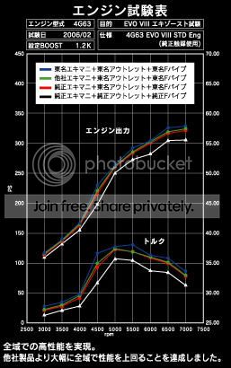

Anyway, it's going on a stock turbo. This is what they claim (which is probably a little exaggerated):
The blue line is apparently stock evo8 + O2 housing (Tomei) + downpipe (Tomei) + ex. mani (Tomei).
