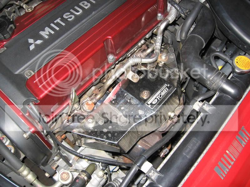

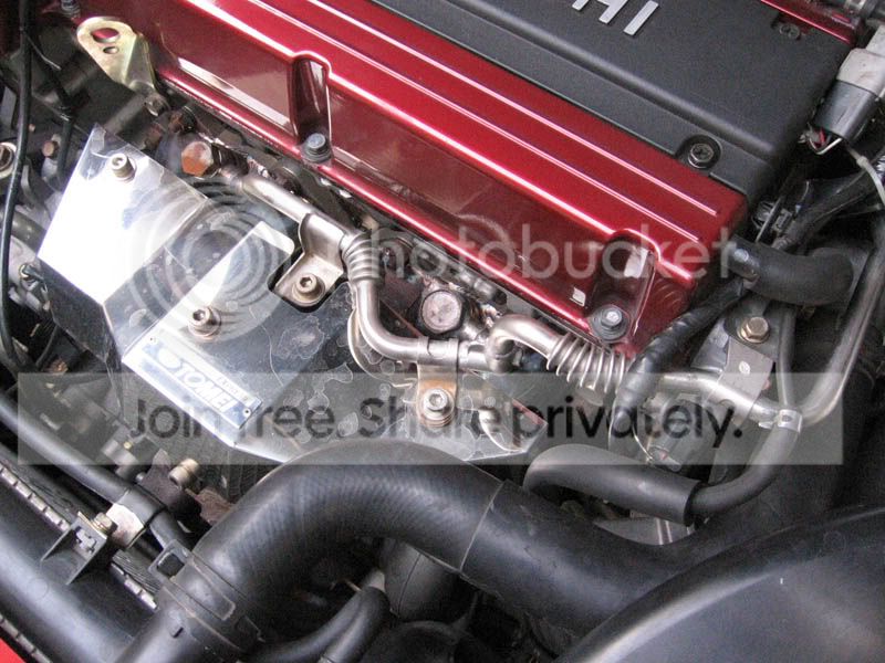

It only took my lazy a$$ a week to get these posted. An before anyone starts b!tching about my engine bay, it's been raining and I'll clean it soon....
Through the hood
