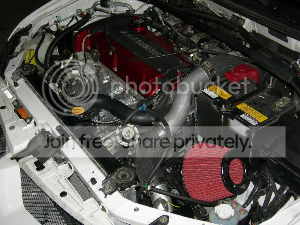

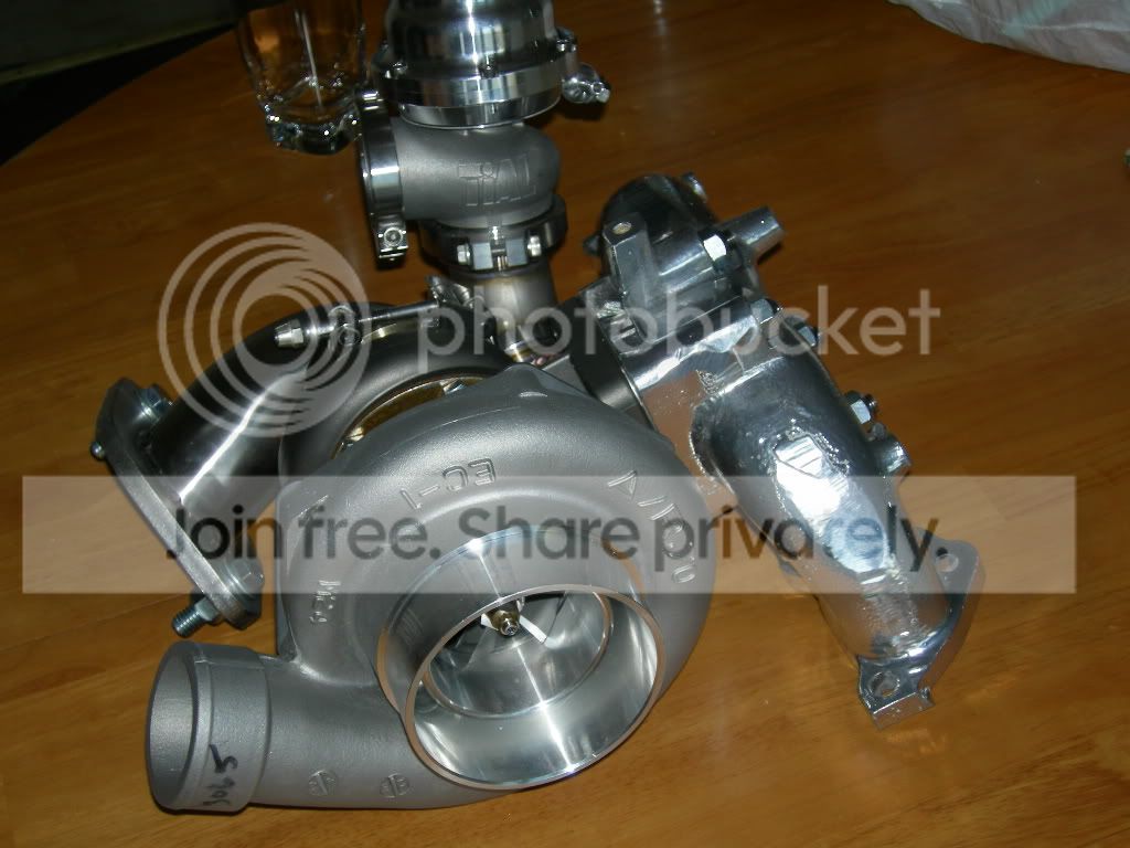

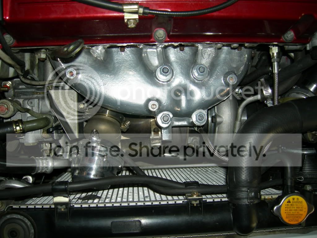

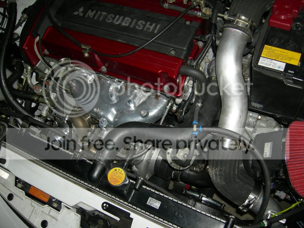

Here you go.
BR3065 on BR's Website
My car:
Hope this helps you out. If you need anything or have any questions feel free to ask.

Very nice kit, love it. This might be the one I get if I ever do decide to upgrade.
Jarrod what was you're best ET again ? I remember an 11.2 @?? If I'm not mistaken? Also, how much power are you lookin at on pump? How much hp is the turbo rated at?

Aint it purty?? I put down 415whp at 23psi with a flash.

for some reason I was under the impression that the compressor section was 30r based....but it looks like a 35?

My car went 11.04 @ 128mph on a 92 degree day with a 1.74 60'. My car is full weight and running 18" VOLKS w/ BFG KDW tires.
My car on our dyno made 342whp on 22psi and straight 94 octane. With C-16 and 29psi it made 462whp. This was all done on a 100% stock ignition, intake manifold, throttle body, head and block. My car is only running our stages 1-4 w/ HKS 272 cams, AEM EMS and this turbo kit.
I just did a few more upgrades but i'm still running the 3065. I want to max it out. I'm going to run it for the first time with the new toys next weekend here at Norwalk at the NOPI World Finals. Shootin for mid 10's now. I am still planning to run my 18" VOLKS and BFG KDW-2's at this event. I dont want to change that stuff because I want it to run the #'s it is going to just the way it sits.... Just the way I drive it on the street. I will make a post after the event to let you guys know what the outcome was.

From what i understand this turbo has the same compressor and turbine housing as the 35r

Jarrod,are you still on stock block??ExViTermini,GT3065 is basically a GT30 exhaust wheel with GT35R Compressor wheel + FP popirety turbine housing.

jarrod,a little off topic? are you only useing one vacum line off that waste gate?

Yes just off the top.
