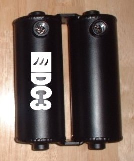

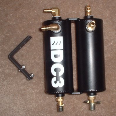

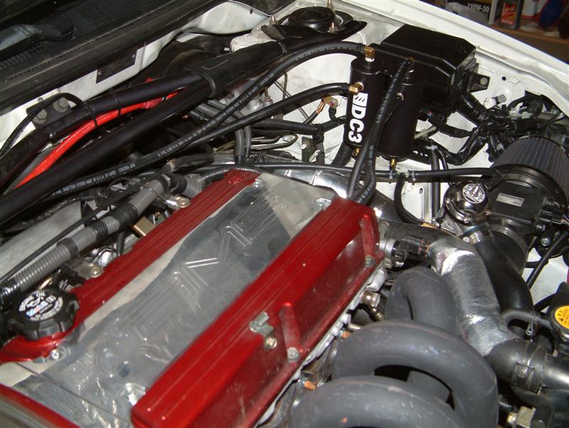

This is a commom problem with 4G63T motors. They have been doing it for years. What solved my problem (did it before motor was built and after) was to use a light spring to attach to my dipstick to hold it down. That worked fine but I still had an ugly little puff of smoke come out of my tail pipe after a really hard dyno pull or street pull that bugged me. Then I read and studied up on the pvc system and a new, really nice catch can system like this. See this thread for background info: https://www.evolutionm.net/forums/sh...d.php?t=200793
Here is a pic or two of what solved my problem:
Whala, no more puff of smoke after hard pulls and no more dipstick popping out. I left the spring on there anyway for piece of mind.
Btw, that photo above is NOT my engine bay. That is a mess.
