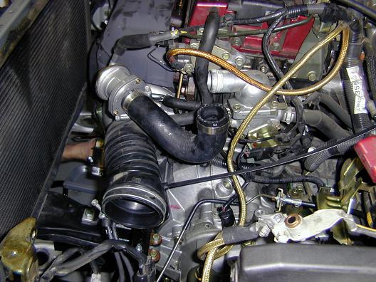

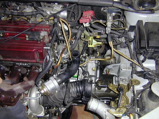

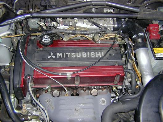

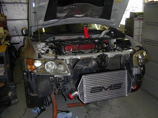

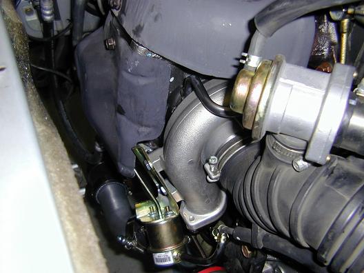

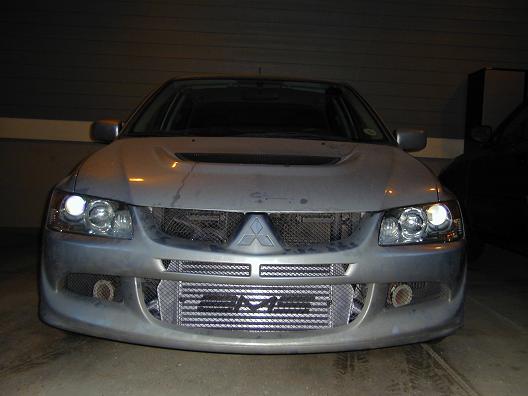

I just thought I would share my experience and some pics of my turbo upgrade. It went very smoothly although basically took all day. I had no issues with any bolts not coming free even after 40K.
The hardest part was getting the banjo fitting back on after replacing my clutch line
I also welded on 2 mounts to the O2 housing for the heat shield. I didn't want to leave it with 1 mount and I really didn't want to cook my AC compressor
Here is what I installed:
FP Evo Green
SS Autochrome O2 housing
AMS Intercooler
AMS LICP
SAMCO Hoses
Full T-Bolts instead of hose clamps
Clutch line and restrictor removal
I found that the 3" t-bolt from this thread is too wide and does not seal correctly on the intake manifold so I ended up using the stock hose clamp.
https://www.evolutionm.net/forums/sh...d.php?t=193838
Impressions:
I will really be able to tell once Shiv comes out next week for my tune. Until then I am just driving on my old map and being gentle. The turbo spools quickly and seems to flow a lot of air. I did a quick 4th gear pull at 3/4 throttle and boosted easily to 1.9 bar before I let off. I had never seen past 1.7 even on a cold day with the stock turbo
I guess I will know more after the tune. Will report back

what a nice intercooler!!!
ps the car needs a baffffffff

Yes the intercooler is a nice piece. AMS does a good job!

might be stupid question but what is on the left and right of the intercooler?

brake ducts it looks like

is that intercooler and direct replacement, like keeping the crashbar or no?
Direct, crash bar is still in place....fits like a glove.

The intercooler is a direct replacement. I, however, decided to pull the crash bar for weight as well as improved air flow.
Correct -- runs to the Forge caliper ducts
