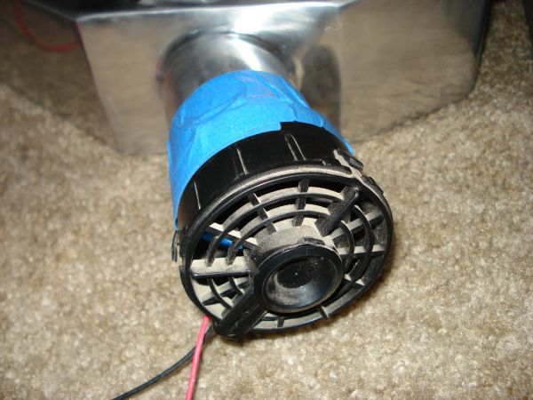

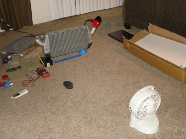

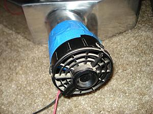

Ok everyone, this is not exactly a lab test but it will work.
A DC motor fan is used to give me a voltage reading. The faster it spins the more voltage out. A Pretty simple set up.
Both of the intercooler are placed exactly the same way.

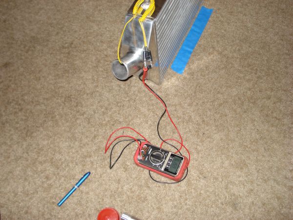

The temperature probe are also placed exactly the same.

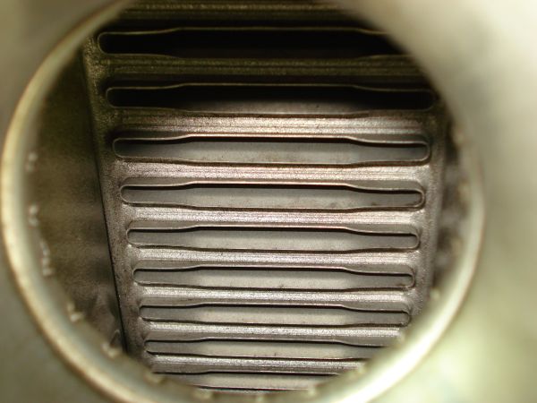

The stock IC has some oil coating on the walls. As you can see its shinny and yellowish.
The 17 row core Ebay intercooler.
Well Heres the test results:
The Hair blower produces 110'C max and an air flow voltage of 3.63v
Stock IC air flow: 2.39v
17 row Ebay IC air flow: 3.13v. Little loss compare to stock.
2min max heat flow test.
Stock IC starting with 13.6'C ends with 18.6'C and rising fast.
17 row Ebay IC starting with 13.1'C ends with 13.4'C and rising slow.
As you can see the ebay IC out performs the stock one. Hope this helps.

I would call this test cute. hardly similates real world conditions.
not enough airflow volume through core, no cooling air through outside. no pressure at all. the flow test may be helpful. but the temp test could be way off for many reasons.
