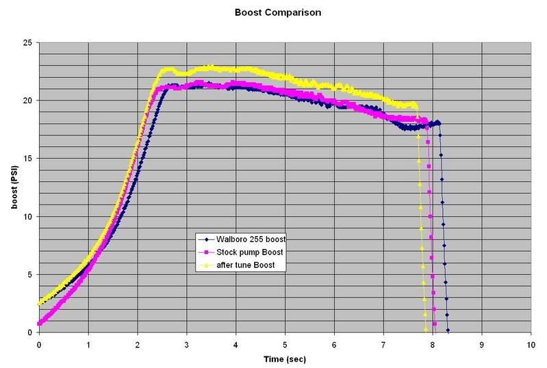

hello everyone,
for a while now i have been wanting to see hard data of how important the walboro 255 fuel pump actually is. i know many vendors have been trying to sell them to everyone, and i wanted to see if this was justified. i know i was strongly against getting a tune after swapping out the fuel pump, but after seeing the data myself, i now stand corrected. here is the data i have collected to compare a stock pump and a walboro 255. the car is a 2003 evo 8 RS. the mods include a ebay TBE with test pipe, manual boost controller, greddy type-S BOV and a dynoflash tune.
to begin with, the car was to be tuned for the exhaust to replace the dynoflash. the first pull i did, we saw the air fuel ratio was 13:1 at WOT at 6000 rpm and up. that was just crazy. i immediately richened the tune up as much as i thought it could handle. and from there i saw it was hitting 100% duty cycle. in the first plot, you can see the duty cycle of the stock injectors with the stock fuel pump touching 100%.
even at 90+ % duty cycle we were a long ways from being a "safe" tune as shown in the following air fuel ratio plot:
the air fuel ratio for the stock pump was still around 12:1, which is much leaner then we wanted. we then immediately went back to the garage and installed the walboro 255 pump in. without touching anything, we ran another pull and saved the data. In the first plot above you can see the injector duty cycles remained the same because we didn't change the open loop fuel tables at all. the only change was the pump. the difference was very visible in the air/fuel ratio though, as seen in the second plot above. the ratio jumped from 12:1 to 10.3:1. this was a huge difference just by swapping the fuel pump. now because the car was running much richer then our target of 11.5:1, we tuned it back to 11.5:1 A/F. the brought the injector duty cycles down to a more managable level as seen by the "after tune" line in the first plot above. the duty cycles went from a peak of 100% to a peak of 85%. the air fuel ratios in the tune left the car running at a perfect 11.5:1 A/F ratio.
in addition to the final tune, we even turned the boost up. in the plot below, you can see the boost we used in the stock pump run, and the run immediately after it were identical all the way to 7000 rpm (sorry the X axis is in Time, not RPM so it was a little difficult to line up the plots the same as far as when they made full boost). the final tuned run had significantly more boost, and as seen above, still had less duty cycle by about 10-15%.
In conclusion, if you are going to mod your evo 8, one of the first modifications should be the walboro 255. that conclusion isn't anything new, but hopefully the data above shows just how important it is to get the tune after you do your first round of modification which should include the walboro. the stock fuel pump really is a weak link in the system.

there is no such thing as duty cycle for a on/off pump. in the plots above it is the duty cycle of the injectors (i edited it to make that clear, sorry for the confusion), with a given pump supplying the fuel. interestingly though, if the stock pump were able to give enough fuel to not drop fuel pressure when the boost demands more pressure, then adding the walboro wouldn't change anything. however, as seen above the stock pump is maxed out with even very minimal mods, and thus cannot keep up to the pressure/flow rate demands. also, you are wrong to assume that simply adding a fuel pump increases baseline fuel pressure. the fuel regulator regulates the baseline pressure, however the stock pump cannot even supply what the stock regulator demands, and thus when adding the walboro we are only achieving what the stock regulator is regulating.
adding an aftermarket fuel pressure regulator on the stock pump wont achieve anything at all because the stock pump cannot even supply the pressure the stock regulator requires, so it would never be able to supply even more pressure from increasing the pressure via aftermarket FPR.

a fuel pressure regulator is a restriction in the system, but it is a regulator, and thus regardless of flow rate, it will still maintain the pressure the spring/diaphram system is holding. because they are boost referenced, when boost pressure is added to the diaphram pressure it increases the pressure the fuel is at (regardless of flow rate). in your case, if you added a second pump and the pressure increased without changing the regulator, you have essentially made the regulator a restriction (more like an plug in the system, only so much can flow through it and your trying to push more then it can flow through it).
you are right, the pump does not supply pressure (it supplys flow rate)... the regulator regulates the pressure. think of it this way, if you have 20 argon bottles connected to a pressure regulator set at 80psi, are you saying 160psi will come out of a pressure regulator set at 80psi if we add 20 more argon bottles? the correct answer is no... adding more bottles does not increase pressure. only changing the pressure regulator will change pressure. (not exactly a perfect reference... but you should get the picture)
now in our case the stock pump is only capable of supplying flow rate for 50psi when the regulator is trying to hold 80 psi (which means the return line will be empty). this would be the case where the injectors are demanding more flow rate then the pump is capable of supplying. now if we change the pump out for a larger pump, we will see that 80psi at the regulator, the return line will ahve some fuel in it, the injectors flow rate is less then the flow rate of the larger pump, and everything is happy.
