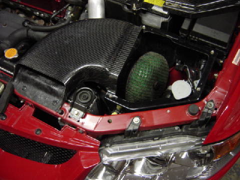

Here is a photo of an airbox that I just installed this weekend. I am using an HKS PowerFlow but a K&N filter set up should work. I have another for sale if anyone is intested $375.00 (just the 2-piece carbon airbox, no filter included) Sorry, but the exchange rate is killing the pricing right now...

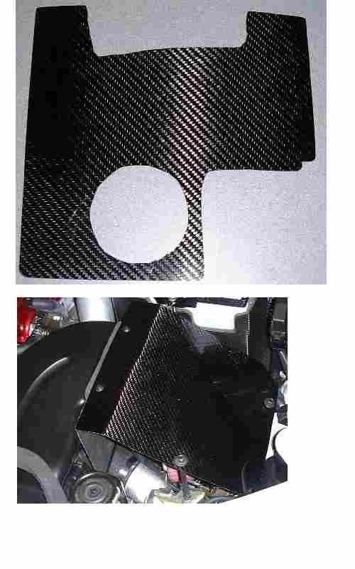

I made my own. An upright head shield and then something to direct the air off the inlet duct towards the filter.
I like that, your price is better then what I've seen else where for that piece.

I did it to allow me to keep the stock air inlet an the air that it can provide. My setup is only the upright to keep some of the enigine air away from the filter and the top piece.
It was not that difficult to make. I used 11X16" sheets of .032 3K Twill Carbon Fiber. Each sheet is like $30, so it's not cheap.
http://www.wccomposites.com/ sells a variety of products, he is also on ebay if you search. To make the cuts I used a Roto-zip with a metal bit. Yes at .032 you can not cut with normal means like scissors etc. A dremel tool can be used too, roto-zip is definetly easier IMHO.
Anyway, the bend in the top peice is simply a matter of heating it in the area you want to bend. You can only bend about 45 degrees or so and have it no affect the structural integrity. If you go 90 it will not hold it's shape. Basically you just heat and bend. I used a propane torch but a heat gun is better. Just hold it to shape until the CF cools back down and it will stay. I should have used a piece of rod heated up to get the bend perfectly straight but didn't think of it at the time.
