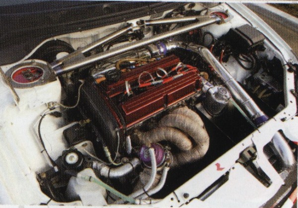

Any plans on an updated design with pipe runs like the Runduce? That would shorten it almost 40" total ... might need a smaller radiator though.
the charge pipe setup on the runduce time attack car is certainly not AC compatible, and it requires a custom radiator/core/endtanks/hoses -- its not a street kit at all. We are building an evo right now which addresses exactly these points, however for 99% of enthusiasts it is not going to work. for the last 1%, wait for the pics we put up in the next week or two
