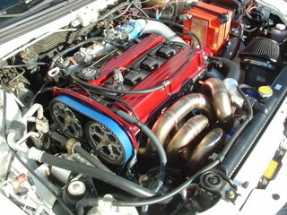

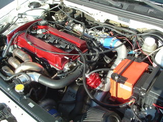

Here are a few pics.. The AEM and FPR is not installed yet but everything else is pretty much done..

looks good
