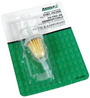

My dad just gave me a great idea... haha I can't believe how retarded it sounds, but... lawn mower fuel filter. Looking at it, it seems as if it'll work. They're $5 and easily replacable once it's starts getting gross and oily. Anybody ever think of this before?
You could use 4 of them, 2 for PCV and 2 for the breather for extra filtering. I think it'd work, what do you guys think?

i ran a clear filter like that between the intake and valve cover on my integra about 4 or 5 years ago, it will do the job just fine

how about the pcv side? looks like a good idea, just cut the hose and put this inline. easy and take about 5 minutes to install or change out when dirty
