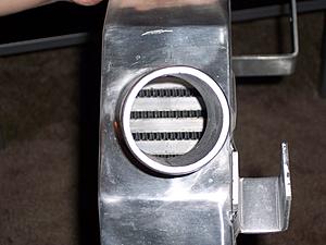

someone post up the inside the end tanks of a ebay/ams copy vs the inside of a true AMS/brand name core.
the inside of the i/c on the left doesnt look very efficient at cooling for high boost. (almost all ebay units look like this). the inside of the taller one on the right has more fins and generates a cooler/dense/more efficient charge.
another pic of the inside of an efficient cooling I/C
i apologize for the large pics... but its all i had

What's the pressure drop on that larger core? It seems that it would be really efficient, but also a little restrictive. I agree that the smaller core has a horrible fin layout. I have pics of my eBay core and the fins are somewhere between the two you posted. It's close to the larger core than the smaller one though ... I'll try to post when I get home from work.

Well going from the crappy core on the left to a Precision PTE 600 i/c core (which was a huge jump) i didnt see any significant drop. my ebc settings were untouched, everything stayed the same except the core and my boost logs were identical while the IAT logs dropped drastically.

I've attached a pic of the fins on my eBay IC. I don't think it's a split fin design but the fin density is better than stock. I paid like $165 for mine shipped.
