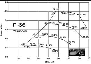

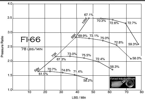

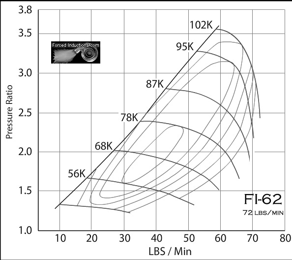

Anyone have compressor maps or dyno charts with a 360 or a 362? I'm guessing the titanium turbine wheel has a lot to do with the BW turbos' quick spool.
None with the 62 or 65, but I did get a dyno chart from FI for a 2.0L Cosworth AWD using the 80mm ETT BW wheel and FI's new big race cover which is above.....Duh for the repost
I did find some compressor maps though... for their 62 and 66.
Attached Thumbnails Does anyone user Borg Warner?-fi62map.jpg   Does anyone user Borg Warner?-fi66map.jpg
