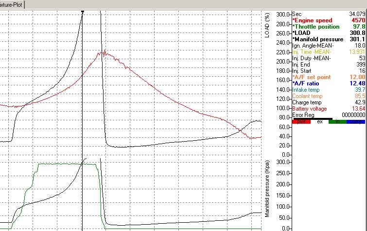

I'll post my results first:
The spec is:
Autronic SM4 tuned by Mark Shead @ M.A.Developments (thanks Mark!)
Magnus long rod 2.4 / 8.5:1 CR
MAD spec Piper cams
Magnus head with standard size valves
AMS GT35R turbo kit with now a HTA35R from FP
Magnus Race Intake Manifold
MAD 63mm ported throttle body
Buschur COP Ignition w/CDI
RC 1000cc Injectors with intank walbro + inline Bosch 044
Cusco Zero2R coilovers + AP 6pot brakes in front
APS Intercooler
30 psi at 4570 rpm.
20 psi at 4161 rpm.

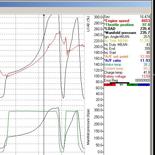

By popular demand
3rd gear is allowed as well.
For my car it is:
20 psi at 4653 rpm
30 psi at 5600 rpm
I must say if you can't do a 4th gear pull to 6k rpm on the street well I guess it's not much fun on the street.
Also if we can please try to keep the thread to posted datalogs rather than discussion I think it would be helpful.

your 3rd gear results are interesting, I just looked up the data from my own 3rd gear logs with a GT35r and they aren't far off from what you are claiming.
This is surprising considering the two major differences between our setups are #1- you have way more mods, including a stroker 2.4l & #2- your boost was set much higher then mine, so while my WG starts opening earlier and spoolup is slowed yours stays closed and continues to build.
I agree I'm surprised as the diff is very small. Maybe it would be more exaggerated if you ran higher boost? Do you have any 4th gear data?
What kit and spec is your 35R?

Wow good stuff guys keep it coming. I was loving how responsive my car was but look at this from KevinD. Almost 30 psi at 5k rpm in 3rd on 2 litre! In my car difference betwen 4th and 3rd for 30 psi is 1100 rpm! So can infer you make 30 psi at 4k in 4th gear?
I'm wondering if something was up with my 3rd gear pull cuz 1100 rpm diff in spool between gears is a lot. There does appear to be some wheel spin in my 3rd gear pull if you look at the dip in rpm. Might have to re-test I dunno.

Compare gear ratios also as yours is a RS and prob has the short ones.
