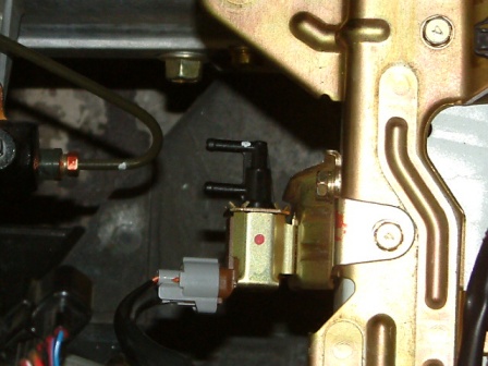

I'm installing a Turbo XS MBC, and have been reading the Forge MBC install "How To" and had a few quick questions to make sure I'm understanding the directions correctly.
1st:
I just use a short piece of hose to connect the two nipples on the factory solenoid in this pic right?
2nd:
It looks like the guy removed the stock rubber hoses and installed new ones. Can I use the stock hoses if they fit over the nipples on the turbo XS MBC, or do I have to use a different hose that may have a different inside diameter? It didn't come with any hoses, but I have 2 sizes of extra vaccum hose I can use if needed.
3rd:
Are there are only 2 hoses I need to run? One that goes from the wastegate actuator to the MBC and the other that goes from the MBC to the pressure nipple on the turbo.
Yes I have searched, but I just want to be crystal clear I understand everything correctly!

don't need to do #1 on your list.
#2 don't reuse the stock lines, they have restrictor pills in them and that will further mess with your boost levels.

and yes #3 is correct

1: I did not reuse the factory solenoid the hallman mbc is itself the solonoid...
2: I installed a hallman mbc and i just connected two vacuum hoses from the mbc to the wastegate actuator and the pressure nipple. You can use the hose size that will allow the nipple to fit over it. You obviously can't go bigger because then it wouldn't fit. You just need a hose that a pressure can transfer threw and bleed out of if necessary the hose diameter, as long as it fits, is fine. no stockers tho.
3: yes only two. well with the hallman again i duno if its the same dude.

Just use new 4mm I.D. hose and ziptie each fitting tightly
A)Run one hose directly from your boost reference source[either, 1) the compressor discharge nipple, or 2) a "T" spliced into the line which runs from the diverter valve to the intake manifold], to the bottom,(or reference) port of your MBC .
B) Run the second hose from the side port on your MBC to the nipple on the wastegate actuator.
Leave the 2 ports on the factory boost control solenoid capped and the BCS electrically connected.
