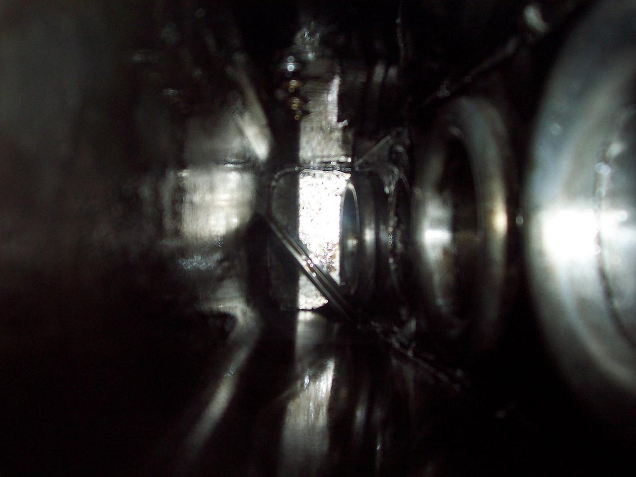

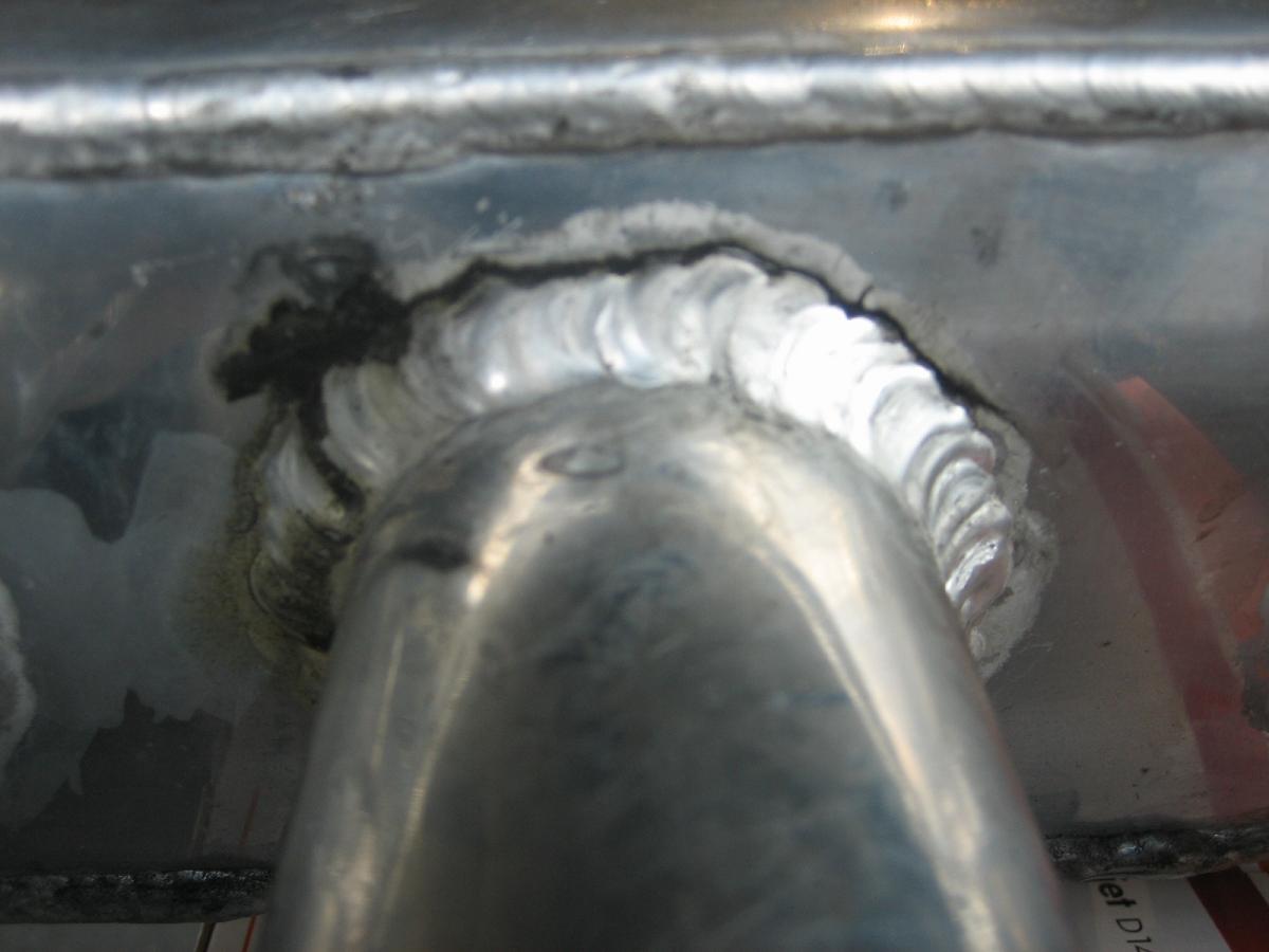

This is why people should heed the advice of NOT running "certain" types of sheetmetal intake manifolds.
It has come to our attention that there are ALOT of different variations of the Magnus Intake manifold. This seems to be one of them. Look closer into the next fews pages for clarification. I believe it is page 3.
AGAIN I REPEAT, this is NOT a MAGNUS manifold, but instead a FAKE. It is not nor was it my intention to bash anyone directly or indirectly.
As a side note which I did not have a chance to take a pic of, but will, the "venturi's" have come apart and sounded like a can of marbles when under boost. Wonder what the knock sensor would think....

pics are very hard to tell where it is cracked but I have an idea of where it is in the pics...

You will notice the carbon buildup around the weld. Ill take some better pics

What manifold is this?

EDITED PUBLICALLY: It seems to be a knock off Magnus from the posts made by MAGNUS himself on page 3 of this thread.

Actually DTM, the first picture you posted showed the Magnus badging on top of the plenum. Did you edit the pictures?
Dave,
I just wanted to show a more detailed pic of the crack. So I uploaded a different image.
