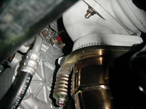

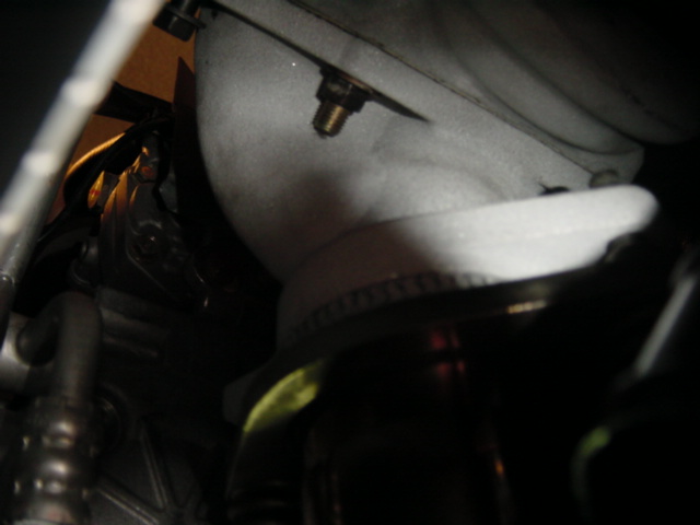

robjeff25's Avatar
Joined: Feb 2007
Posts: 88
From: NASHVILLE, TN
here are the fitment pics; help me out; is it suppose to be flush? i dont remember it fitting this way with stock o2 when i installed the perrin dp;
Attached Thumbnails dp to o2 install-dsc00945.jpg   dp to o2 install-dsc00946.jpg
Old Feb 20, 2008 | 06:08 AM
deadbeatrec's Avatar
Joined: Jan 2005
Posts: 3,139
From: Albany, NY
looks to me like it doenst fit.
Old Feb 20, 2008 | 06:21 AM
robjeff25's Avatar
Joined: Feb 2007
Posts: 88
From: NASHVILLE, TN
that's what i was thinking; any other opinions?
Old Feb 20, 2008 | 06:58 AM
robjeff25's Avatar
Joined: Feb 2007
Posts: 88
From: NASHVILLE, TN
i removed the stock donut gasket and installed the gasket that came with the megan o2; fitment seems better, but will definately put sealant for a better fit;
Old Feb 20, 2008 | 09:46 PM
eponti's Avatar
Posts: 900
From: RENO
I dont think its supposed to be flushed with the o2 housing.
Old Feb 20, 2008 | 10:04 PM
chaotichoax's Avatar
iTrader: (149)
Joined: Apr 2005
Posts: 6,108
Likes: 18
From: New Jersey
it shouldn't sit flush with the stock donut gasket
tighten it up evenly (a little bit on each side at a time)
