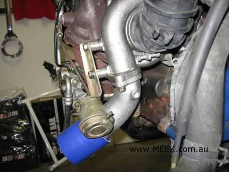

No the spool up gain is like 200-300 rpm earlier.
And part throttle spool is improoved.
so yes it is worth doing it.
And we have always made a compressor outlet since galant VR4.
Both the pipe and outlet are sold seperatly.
$200 AUS for each peice without local GST.
Do you guys realise Buscher Racing pay for full page ads in our mags down here.
Did not think you guys were ready for this kind of quality.

^^^ Junk.... how can spool be improved if you are increasing the area needed to be filled and it wasn't a restriction in the first place.
This is not a VR4.
This is a BS attempt at advertising.

Its every bit identical to a VR4 and Evo 1,2,3,4,5,6,7,8,9.
It stays 44mm all the way on that metal outlet.

looks like a nice piece..
restriction has an affect on spool. not just area.

Look man.... the stock intercooler pipe may look like a restriction but its not. Its just funny looking. I've been there and done that. I even tested stock vs AMS on a dyno there was no difference at all.
The stock pipe is good for at least 50lbs of airflow and you aren't gonna speed up spool ESPECIALLY 300 RPM by putting a bigger pipe in there. If you aren't seeing gains when boost is maxed out how the hell are you gonna say its much better flowing when you aren't even at full boost.
Also there's a reason why mitsu used the rubber piece near the downpipe. Its because aluminum and steel absorb heat like a flipping sponge. So adding this pretty metal pipe will more than likely do more harm than good.
Its a ricer mod. Some people are even putting heavy pipes with no mounting brackets in there. That is just silly. You can swallow and burp this hype up all day long if you want to. But I don't have to.

It's all about airflow. This combo seems to be the smoothest transition & least disruptive LICP I've seen. It looks like a very well designed setup. It's a little pricey, but nice. I would consider it if I didn't already have a LICP

What do you mean by increasing area? It apears to be the same diameter as stock with a smooth transition outlet leading to it.
