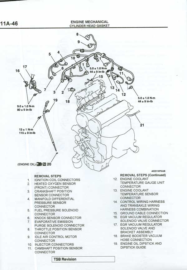

Hey everyone, I did a search on "knock sensor location" and only found this prieviously 2.5 year dormant thread, but anyway,
Where is the stock knock sensor?

follow the connector
I think it's on the front of the engine under the manifold but be sure and just follow the connector.

right here
Back side, sorry.
