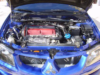

I used a Miata battery on my Evo 8. I just cut the factory batter tray and drilled 2 new holes for the tie downs.
It worked perfect with a Muse short route uicp (similar to Buschur's)
Here's a pic with a stock UICP
And here's a pic with the short route pipe
I prefer the Miata battery since they're easy to find and under $100 with replacement warranties. I had a couple 240sx's that required em which got me hooked on them. It'll fit into the factory tray sideways. I believe the dimensions were 8"L x 6"W x 8"H but I don't remember since the car has been sold.
