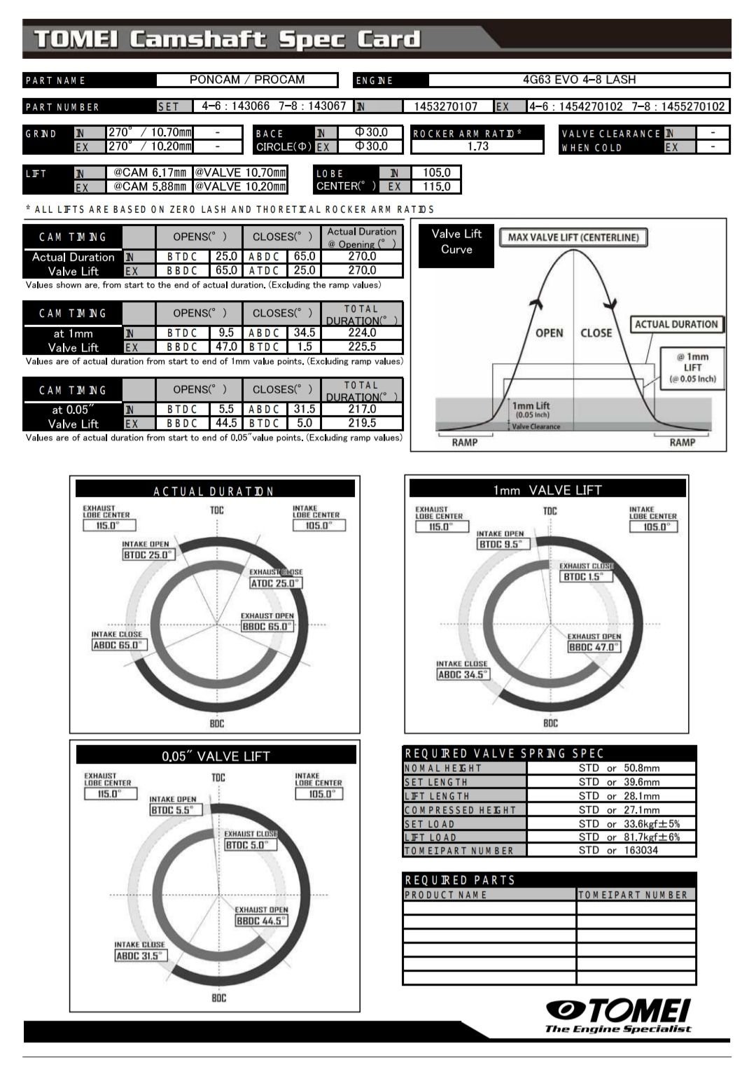

Originally Posted by Ted B
-2/-2 will give slower spool but a bit more hp around the peak. This is good for 1/4mi drag but not as good for street work.
Thanks!
Then can this setting be a golden mean: -2/-1 or 0/0 ?
Maybe it would be worth replacing the GSC S1 with a Tomei poncam type-r 270 or the US markt Tomei poncam 270 which is 272 degrees? Because it would work with factory valve springs (10,7 and 10,2 lift). Would these give more in the upper range?
Thank you for reply,
Ben.

In theory, the slightly longer effective (@1mm) duration of the Tomei cams should give a little more in the upper range. In reality, the turbo will be the limiting factor. Changing the turbo is a better option than changing the cams.
Understand.
Thank you for reply!
You told the 0/-1 or 0/-2 (bigger midrange torque and quicker spool) or the -2/-2 (slower spool but a bit more hp around the peak.) settings... And then what would be the best medium cam timing setting... possibly: -2/-1 or 0/0?
0/0
All GSC cams have lobe centerlines and lobe separation angles that are intelligently selected to make a good compromise for a variety of situations.
One last question..
If I sell the GSC S1 cams... Which Tomei cams should I buy? Tomei poncam type-r 270 or the US markt Tomei poncam 270 which is 272 degrees?
Which one has better specs?
Old Jun 11, 2023 | 05:49 PM
  #396
Ted B's Avatar
Posts: 6,334
Likes: 63
From: Birmingham, AL
If I had to choose between the two, I would take the 272 set, which appears virtually identical except for a few additional degrees of effective duration that can be manipulated with cam gears. No matter what you do, you will still be limited by that turbo, not cams.

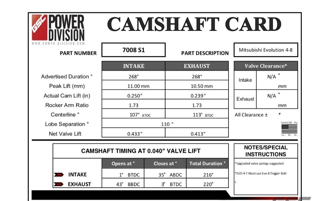

Hello!
Since than... I have already bought a bigger turbo (20g billet..)
What would you recommend (cam gear timing settings)? Thanks (2.0l 4g63 Evo 8GSC S1 camsWalbro 340l/h fuel pump3" APS Exhaust SystemHKS RS intake kit.)

Sorry, I almost forgot about responding. The 20G upgrade is not something that would change things to a degree that would alter the cam timing scheme. My original recommendations apply.

Hi Ted,
With the gsc s2 billet camshafts is the 0/0 setting the best?
I'm wanting more midrange/spool with my current set up.
Gsc s2 cams, vband gtx3576 gen 2. Stock port head. I'm seeing around 25psi by 5200rpm. I willing to trade off top end for more mid range.
I have the old school jun cam gears but there just set to 0/0. I believe they have 4 degrees advance/retard.
Old Sep 17, 2023 | 07:37 AM
  #400
Ted B's Avatar
Posts: 6,334
Likes: 63
With the GSC S2, the 0/0 setting provides a very good compromise for all around performance. If bigger midrange punch is desired for street and short track work, I suggest retarding the exhaust cam 2 degrees. This tightens the LSA from 110 to 106 deg while leaving the intake cam LC at its fairly advanced LC of 106 deg. The idle will be noticeably lumpier, but spool and midrange torque will be quickened and fattened.
