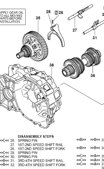

Could be the shift fork also. They can get bent during fast/hard shifting. Part #28
I was unable to find the part on mitsubishiparts.net Only the whole tranny. It would be a pita to replace as you have to dissassemble the tranny.
