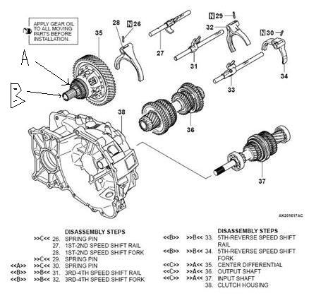

Why do you think there is TWO hollow output shafts coming out the tranny that the transfer case connects to?
Like I said, I run a Kaaz center diff in my tranny, and no VCU in the tcase because the Kaaz is a proper LSD versus the stock open center diff.

Not semantics.... below is the center diff and the A arrow is the output shaft for rear wheel power and B is front wheel power. What do you call something that splits power from front to center?

After careful review of your info and mitsubishi wording I will agree with you and admit I am wrong.
The stock center diff and gears live in the tranny.... they work together with the ACD/VCU which sort of functions like the LSD for the front and rear split.
