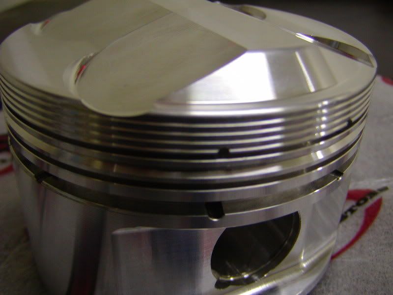

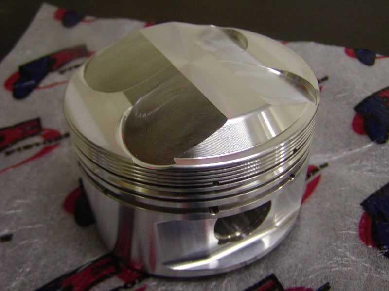

Guess my compression? Winner will receive fame and fortune...or something.
Yes these are for a 85mm 4G63. The rest of the build is currently hush hush as the customer prefers anonymity. These have lateral gas ports, accumulator grooves, contact reduction, and window milling. They still ended up a little porkier than I was hoping though.
Old Jan 22, 2009 | 11:03 AM
  #94
E7R's Avatar
E7R
Joined: Nov 2007
Posts: 177
From: Hellas
Originally Posted by JohnBradley
Then you need to account for fuel sometimes as well. I love the tech in this thread, well done Ted
11:1 ???? (!!!!!!!!!!)
whats the weight?

12.75:1 for the static compression on those high dome pistons.
Josh

376g...more like Sumo than Ninja, but its what it takes. For the guessing game (for those playing) I'll announce the winner in 2 days
