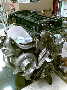

Here are some pics of my car being completed...
Attached Thumbnails HKS 2.3kit + GT3240-15102008011.jpg   HKS 2.3kit + GT3240-e024.jpg   HKS 2.3kit + GT3240-15102008013.jpg

Here are some more. The car is 100% completed now but I havent taken pics yet. Ill try to take some and post them as well.
Attached Thumbnails HKS 2.3kit + GT3240-18102008017.jpg   HKS 2.3kit + GT3240-15102008015.jpg
