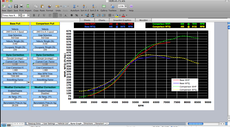

If for example we set a boost limit, let's say 30psi which is doable on straight pump, I don't think that any of the stock frame turbos can reach such high power levels...
If someone wants mega power all the way to the redline, then go big
if someone can settle at 450-500 whp pump then go with a stock frame turbo
but remember, a stock frame turbo will never reach the power levels of a good billet turbo...
Now real street performance. Without having the optimum setup and still in the stock itake manifold, stock throttle body, unported head my car on the FS365 sees:
20psi at around 5050-5100rpm and it pulls all the way to 9000rpm.
You have to think what you want to do with the car. Street driving? Highway pulls, road racing? Drag racing? That's how you should choose your turbo...
Below a basic graph of the three turbos that had/have on my car... I mostly drag race...
two 3rd gear pulls on pump. The low one the car was running low 10s afrs. The high one ran better afrs and a bit more boost...
is there lag? Sure! But the top end makes up for the lost time. And of course people, you all know how to downshift, right?
