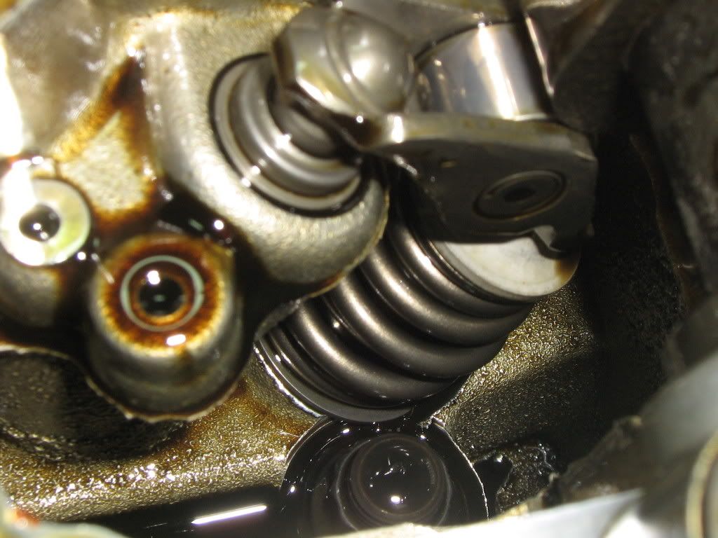

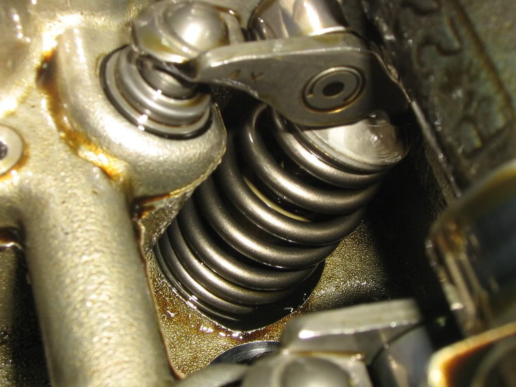

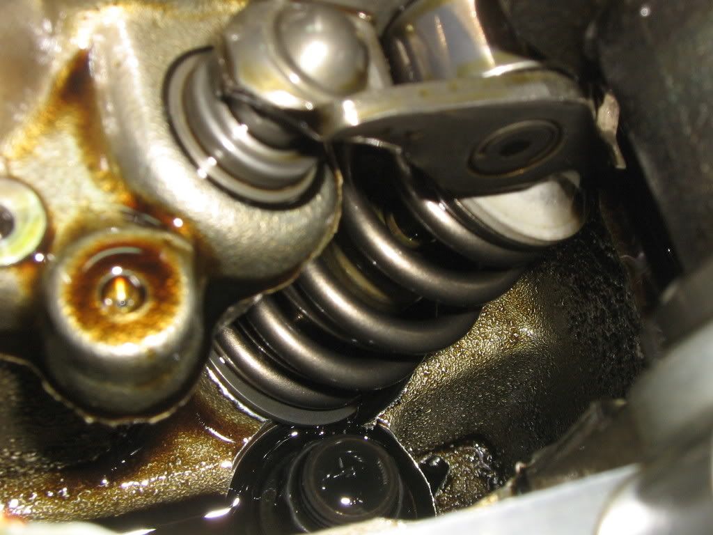

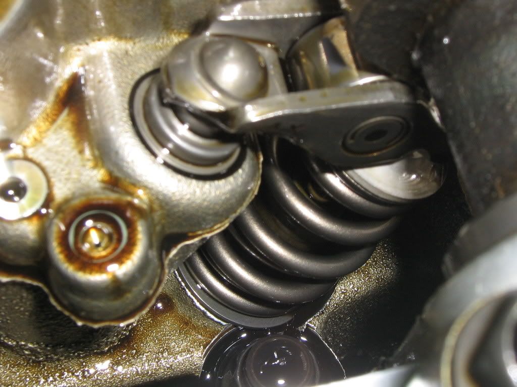

Took off the cover, the cams look good and the rockers are all there, but the first exhaust spring looks suspicious.... like the coils have bound perhaps the valve is bent? Here take a look...
Here's #1 open
Here it is closed...
Now here's what the rest look like, here's #3 exhaust open
Here it is closed
Back to number one, here's a different view, then a top looking down view
Need second opinion before ripping the head off, am I imagining things here or does that look wrong to anyone else?
