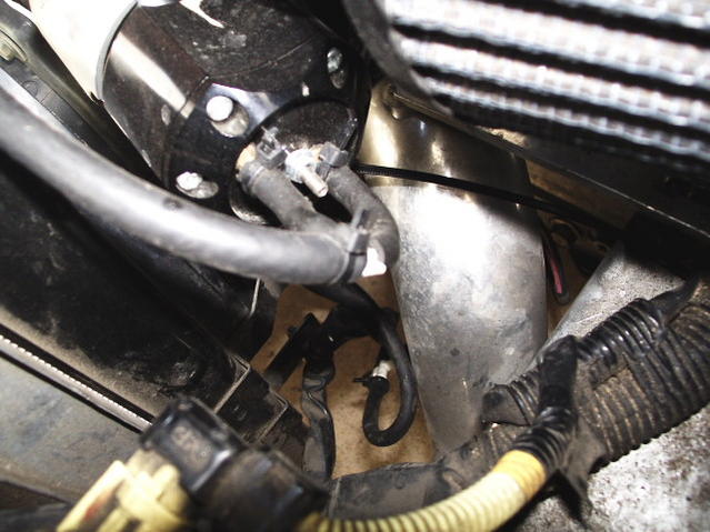

Fix your exhaust leak and check for boost leaks as well. I though I was ok and found a vacuum line disconnected causeing a major leak and making my bov flutter so bad it would pull me out of boost in 5th.
I currently only experience a little flutter when releasing the gas at low boost in 5th gear only.
A and B are on one " T ". I believe that A goes straight to boost source at manifold and B " T's " into it. The second pick show C going down to boost source of the turbo outlet pipe. C goes straight to the boost source and my EBC " T's " into that line.

A will try to get pics of the area it was in. I was on the passanger side of the car under the intake manifold. With it quiet outside I did a boost leak test and heard the swoosh noise. I just followed the sound. With the vaccum line disconnected I did not throw any codes.
