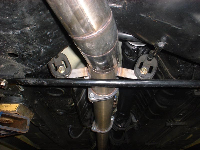

I tell you what... it is simply amazing what a little bit of research can achieve when you are curious. I haven't said a word.... but may I direct your attention to a pic that is found on UR's website... find anything DIFFERENT about the test pipe in this picture?
This is all I can give.
looks to me like the O2 sensor plugs into a small pipe extended from the test pipe.... Which will reduce exhaust gas flow over the sensor... Now you do the math
