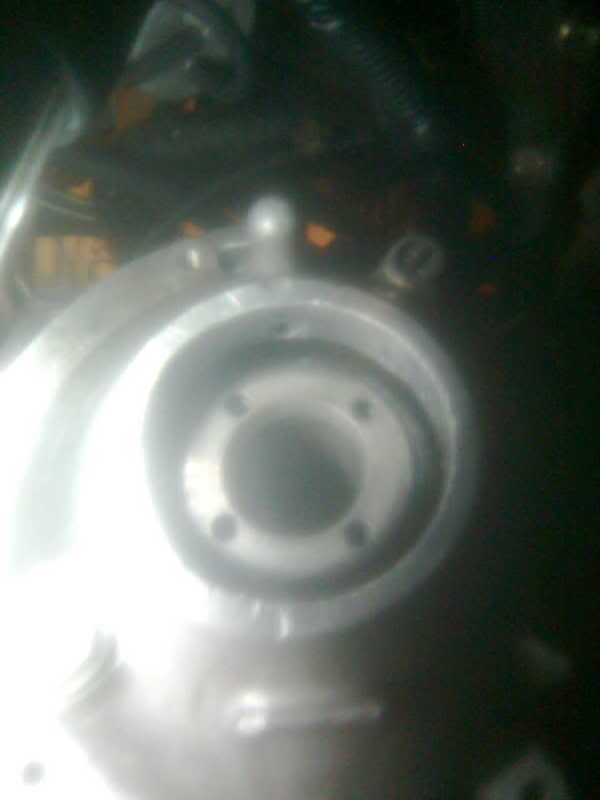

thanks buddy yes th pipe is a good idea! i used the cup off my axel and yes i had atv blue gasket sealer in my hand for the pass few days trying to figure out if i wanted to use it or not haha! ( in my head im like the factory seal should work with out any modding) but i messed up my seal so i will trow in a new one then bead the atv around the outer part for a good seal!
anyone know whats this hole do? is it a vacume.
its a little hole

the little hole at the top in side where the seal fits!

did you pull the axle out in the last pic to replace the seal? i would put the silicone on the seal seat before you install it

yes i did! what was that ?
should intsall the new seal then bead the silicone around it so it attach;s to the seal and t-case wall!?
or do you mean put silicone on the seal then install it in the -t case?

Originally Posted by barneyb
Thanks for the picture but it is blurry. If you are meaning the green part that is the outer housing for the CV joint. I think I see a dent on the backside that looks like somebody applied too much force when trying to remove the axle. If it is not deformed on the inside it should be okay. Otherwise, replace it.
The axle seals are easy to damage when inserting the axle. Take special care not to allow the splines to touch the seal.
Yeah blurry picture. The seal on the TC is to keep debree out with the assistance of the cup on the axle, and to keep the oil in the TC. This is typical on almost any diff. case that doesn't have bolted axle cups.
My seal was leaking, I replaced it and no problems anymore. Be sure that when you replace the seal and install the axle, that the axle goes completely in the TC. The axle has a outer race that seals against the inner part of the seal, if these two do not sit properly it will still leak.
