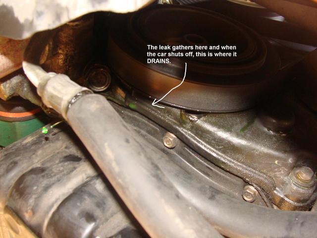

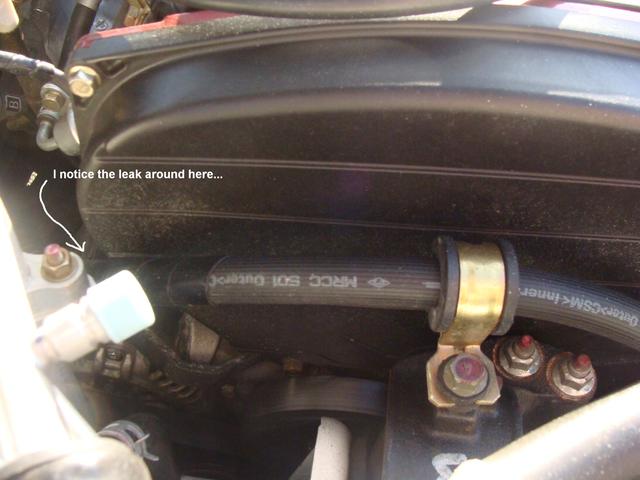

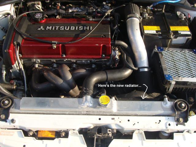

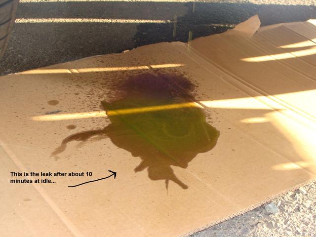

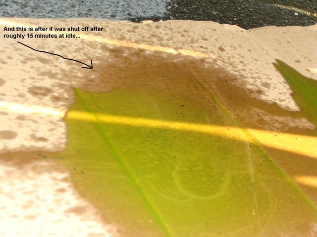

What the heck is going on?? I just bought a new radiator and now everytime I drive, the car literally DRAINS the coolant and I cant find exactly where its coming from... I had the aftermarket radiator cap on, but changed today to the stock cap. Here are the pictures I took from what I found:

Water pump.

+1/\ water pump has a weep hole and once the bearing fails or seal fails, it will drain from said spot. pull the timing cover off the top and look down between the cam gears. you will see the pump. if the timing belt is wet...stop driving it if you can before you slip the timing belt and slap all the valves and have a bigger problem.....

The added pressure from the aftermarket cap was probably the final straw and caused the pump to start leaking.

Yep, no doubt about it. Definitely the water pump.

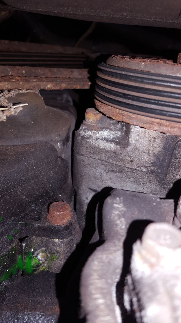

coolant leak
I have a 03 Mitsubishi lancer oz rally that has a coolant leak behind one of the pulleys and I don't know what it is any ideas
