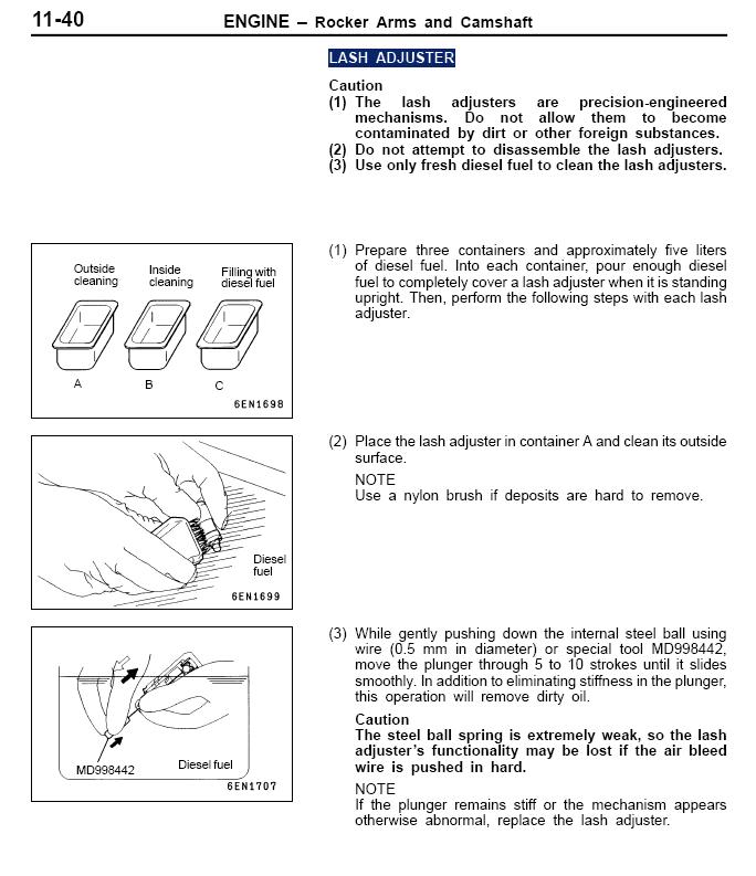

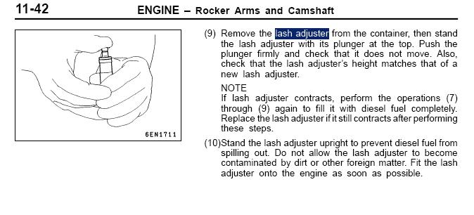

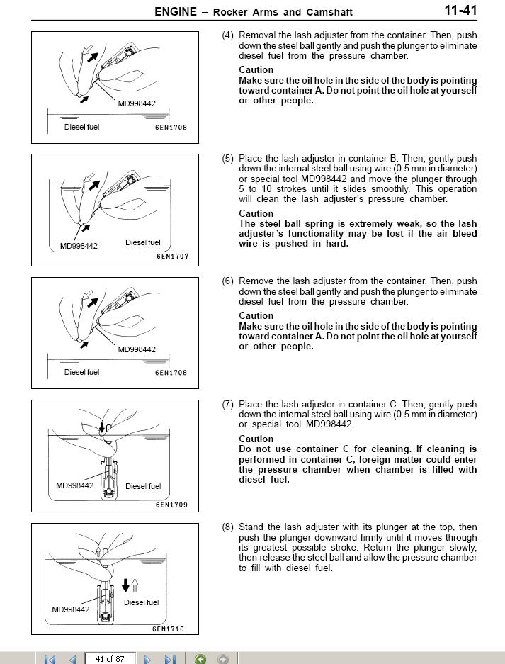

From the Evo 6 Workshop Manual:
Old May 13, 2009 | 08:41 AM
crcain's Avatar
Joined: Oct 2002
Posts: 2,788
I've always gone by the workshop manual and cleaned and primed them with diesel.
