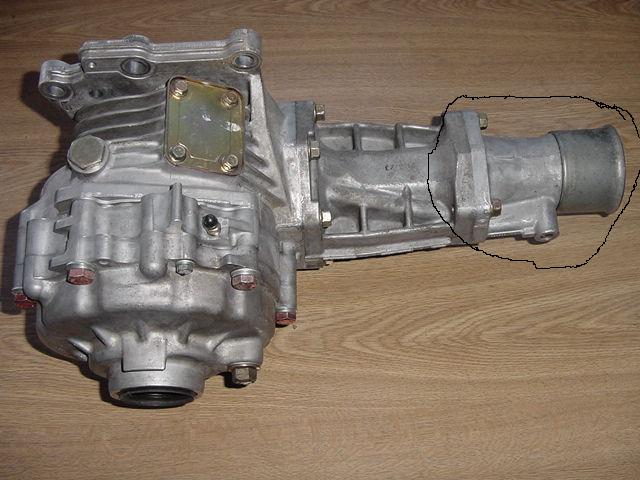

I recently changed my passenger's side axle on a 2003 Evo 8, due to having a torn/destroyed boot. During the removal of the axle, in my haste/inexperience, I managed to "ding the hell out of" the seal on the transfer case.
Basically, the picture I included shows a transfer case, with the area that is now leaking/buggered up circled.
I know am aware of how to remove the axle correctly (ie, don't dig your screwdriver into the rubber and jiggle it all about), but I need to replace the seals/gaskets in the existing transfer case.
Is there a part number/instructions for this? The most difficult part is "removing the damn axle yet again", but, hey, second time is always easier.
I know it's leaking from there for a fact, since, well, you can just see it. It's hilariously leaking. It's not even attempting to stay in .
Thanks!

I just replaced mine, part # is mn132370.

Awesome, thanks! Any amazing trick to getting the old one out, and the new one in?

Remove it with a screwdriver, make sure of not touching the second seal behind.
To take back it up use a tube of the diameter of the seal.

Hope its just the seals...Mine had a hairline crack in it. Kept leaking after replacing the seals.
Had to send it to shep for a built one.

Alrighty, I thank you all again for your assistance in finding the part number.
We changed it today, and managed to bang the new seal up again installing it. This was with a PVC pipe piece that was about the right width. In installing it, we managed to chip away some rubber... thus, leaking.
Short of "being more careful, dumbass", is there something we're missing in installing this? The seal is obviously tight enough that it doesn't just "push right in", but is gentle and loving enough that "taking a piece of wood and a hammer to it, and the rage of a thousand Vikings" tends to damage it.
