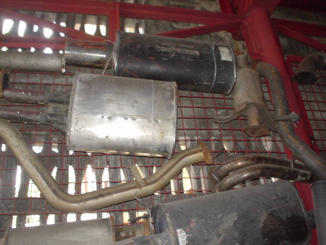

Basically, What is the difference between turbo and cat back?
And, how can you differentiate one from the other?
Asking you this since there is a junkyard here selling used Japan exhaust. I'd love to buy a turboback, but I dont know which one is the real deal.
Attached Thumbnails What is the difference between turbo and cat back?-dsc00227.jpg

its very simple:
a catback is from the muffler all the way to the cat. a turbo back also includes a downpipe and goes all the way to the o2 housing or sometimes even replaces the o2 housing. the optimum setup is a turbo back for a turbo car since it lets you free up the car for more flow.

From: Richmond, VA
A pipe comes down from the turbo to the catalytic converter. That is the "downpipe". Then you have the converter or some people use a "cat-delete" pipe (which is illegal unless used off-road) - this section of pipe is about 12-16". After that of course, is the "cat-back" section of the exhaust which includes the muffler and sometimes a resonator (to make things quieter).
All 3 sections (downpipe, cat, and cat-back) can be replaced at once, or individually.
