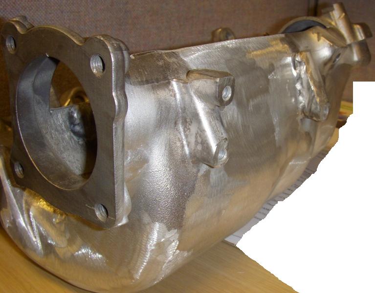

On to the modifications.
First things first, I had to add material to where the factory didn't put it. I welded up the back of the runners so I could make the back of the plenum more flat and not have the protrusions into the air flow region. I also cut off a lot of the unneeded casting items, I'm a pound pincer and I've been liking steak too much lately so every pound off the car counts. The two casting pieces left are for clamping it down on the mill. Not so obvious in this picture, but I also welded up the EGR port in the plenum area and built up the throttle body inlet area (which you can not see at all) to help soften the transition into the plenum.
I also took the opportunity to eliminate the EGR passage. I'll be blocking the EGR port off inside of the head.
Next up I put the manifold on a mill to get rid of the majority of the dividers. I took some pics, but didn't check them before I got out the grinder and did the porting. The pics didn't turn out, so I don't have anything to show at this stage.
Here are the dividers after some port work though. This is looking into the throttle body inlet, similar to the picture in the post above. I'll post the dimensions of how much I cut out and the final runner lengths tomorrow.
One more picture of the runner dividers and of the throttle body inlet. In this one, you can see where I built up near the throttle body.
Attached Thumbnails Modifed stock intake manifold-back-modified.jpg   Modifed stock intake manifold-egr-eliminated.jpg   Modifed stock intake manifold-modified-dividers.jpg   Modifed stock intake manifold-modified-tb-dividers.jpg

My biggest problem at this point is that I would like to double weld the front plate back on and there is no way I can get my current torch in there that far.
<- needs a longer torch

Wilson balanced the runners, that was where the work was done. There is welding done to the actual runners on the V2's and a lot of port work was done after the welding. The largest gains in balancing flow is just from working the inside of the plenum like you are doing.

David, I've made the assumption all along that the Wilson manifold did not alter the exterior of the manifold. This would essentially limit them to nearly stock runners as the casting is quite thin (roughly 2.0mm thick). Other than building things up internally, I didn't see them modifying the runners much.
However, after looking at a few things in the runner and realizing that may have just been a stupid assumption, I think I have drastically underestimated the amount of work done by Indy and Wilson. I am starting to see where the $1500 price tag may have come from.
