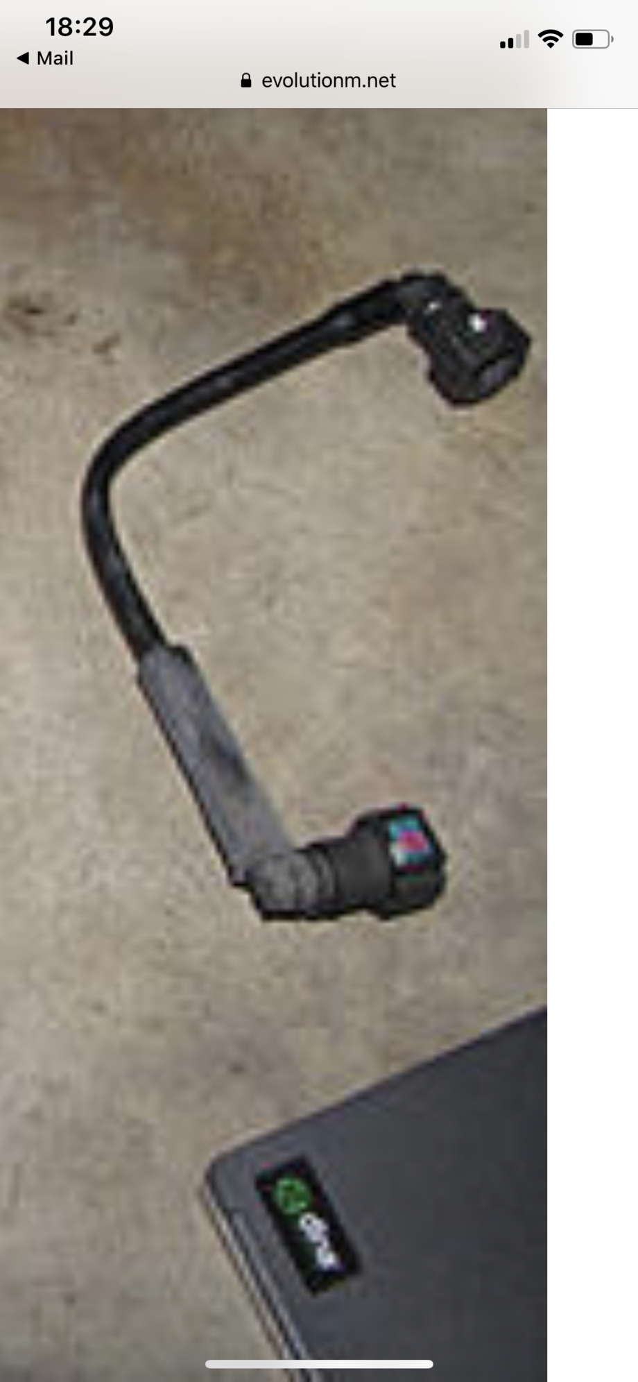

Which line?
This one
Old Aug 22, 2019 | 06:32 PM
RazorLab's Avatar
Posts: 14,094
Likes: 1,092
From: Mid-Hudson, NY
Push the tabs in and pull it off. Super simple
Old Aug 22, 2019 | 06:39 PM
Rome97's Avatar
Veteran: Navy
Joined: May 2016
Posts: 35
From: Whidbey Island WA
The one thats not attached to the pump but the line up under the sheet metal piece
