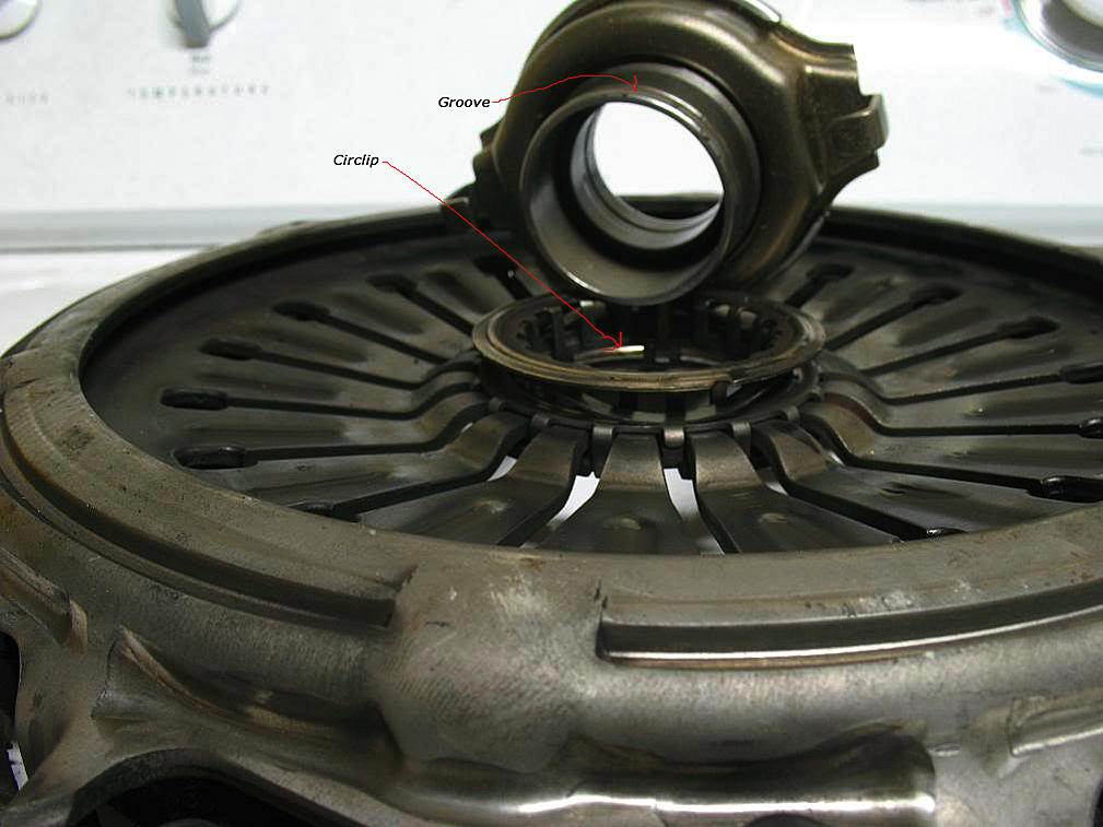

With the trans out and the pressure plate still attached to the TOB, you should have access to the rear of the TOB nose. You should also see where the wedge collar fingers are holding the TOB in place due to the circlip. You should be able to just expand the gap on the circlip and the TOB should be able to slide right out.

I attached a pic, from the back side of the pressure plate, which should be easy enough to identify since you've got the trans out, you should see the TOB sticking through the wedge collar. You should also see the circlip, which is what makes the TOB click in place and stay there. The circlip has a gap. If you expand the gap, the TOB will come out of the wedge collar easily.
