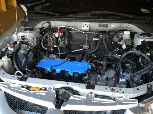

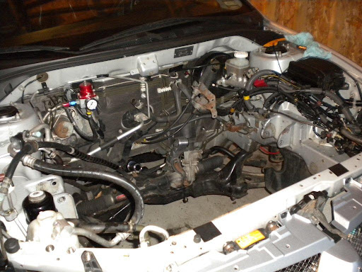

Long over due for an update...
I've been busy especially the last few weeks. Deciding final details on the engine / head etc...
My FP Black was rebuilt after a failure of the thrust bearing. I'm hoping they offer a BB upgrade soon, as I will definitely hop on it.
I have decided on an English Racing Built 2.0:
Wiseco 9:1 1400 HD's - Coated by TCC
Manley I-Beams - Coated by TCC
ACL Race Main Bearings
AMS Wet Sump Oil Pan
ARP Headstuds (Not L19 as per Aarons suggestion)
Cometic Head Gasket
GSC S2's

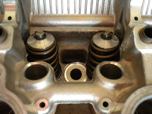

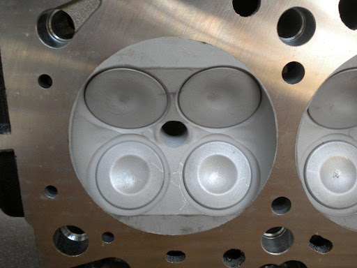

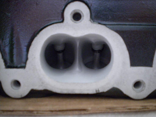

I had MAP build the head. It's their Stage 3 offering with:
Kiggly Valve springs / Kiggly titanium retainers / Kiggly valve seats / Kiggly HLA / Supertech black nitride intake and inconel exhaust valves / Supertech valve guides / Ferrea valve locks / MAP EGR blockoff plate / MAP ceramic coating and thermal block

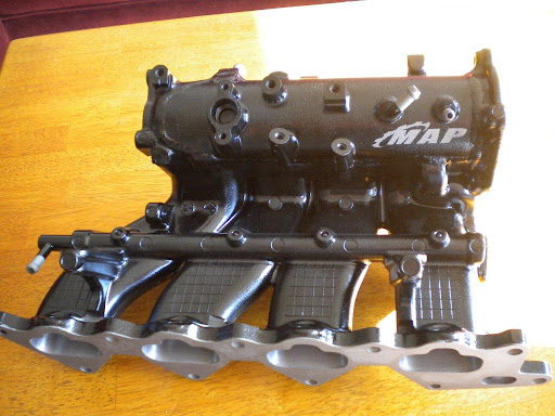

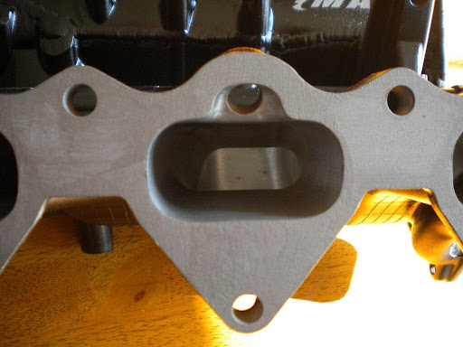

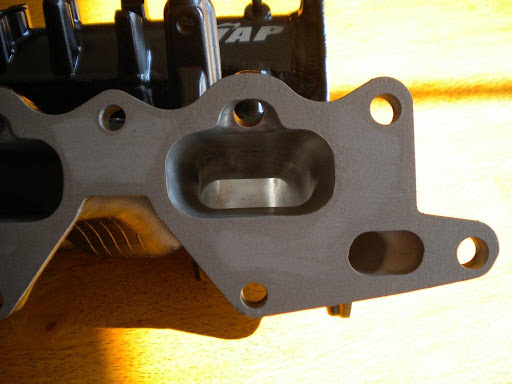

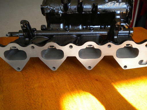

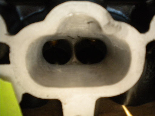

I also had MAP port and polish my stock intake manifold. I believe they may have messed up and given me their REV3 instead of their REV2, as my plenum was cut (maybe not?). Either way, it came out great
I am also going to send my transfer case out to Shep to have it looked over (and upgraded with a Quaife LSD) before everything goes back together.
Upgrading to Buschur's double pumper setup as well as FIC 1650's (or bigger, as this has yet to be determined).
I'm going to send the head and block to Aaron and it will come back as a long block ready to drop in !
Anyways....
Here's some pics:
-Bink

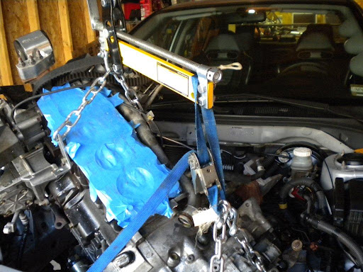

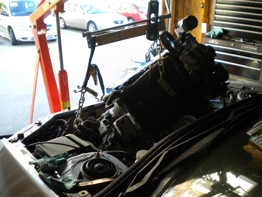

Wow good progress and the choices you made. I like that engine angle dealy you used to pull the motor out. Where did you get it? I might need to get one for when I pull my motor.

They are called "Engine Load Levelers."
Such as this one.
Thanks buddy Took a long time to go over all of the available options out there...
It's called an engine 'load leveler', it came in real handy. I got it from Harbor Freight for 30$. Here's the actual one I got http://www.harborfreight.com/3-4-qua...ler-67441.html
Such as this one.
-Acree
Exactly
