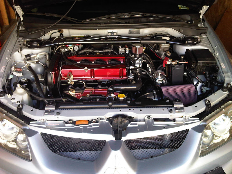

The Evo Lives....
After many hours it's finally done.
I put 53.4 miles on it running Brad Penn SAE 30 'The Green Oil' for the initial break-in.
The break-in was done by accelerating in different gears and letting the motor slow the car down in order to seat the rings properly.
She didn't like to idle. With the said....the GSC S3's are awesome. They sound really mean. I adjusted the BISS screw per Lucas's advice and used Evoscan to activate the solenoid and it finally idled
I then drained the oil and switched to AMSOIL ARO 20W-50. And drove another 30 miles. The car has ~80 miles on it. Right around 70 miles it really started to drive nice and runs and idles like a champ.
Here's a teaser:
I'll upload a video in the next day or so
-Bink

Nice! Good to hear you got it running and running good. Make sure to check your oil level regularly. Break in miles are not fun. I only have about 400 more to go though. How many break in miles are you going for?

Looks amazing Binky. Can't wait to see you get that thing on a Dyno. My car will be going back on the dyno next week and 45psi. Should be interested. Let me know if you ever need anything brother.

Write up on cleaning the engine bay!! That looks amazing!
