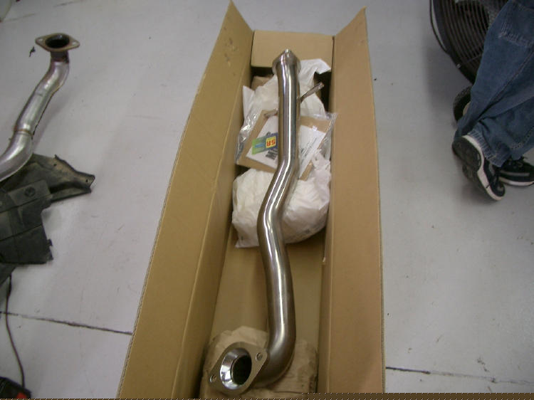

SilverEvo8owner's Avatar
Posts: 1,907
From: dublin, oxford, chillicothe OH
I have the HKS downpipe bolted up to the perrin cat delete w/ 02 simulator (which i can't get to work) with RMR catback.

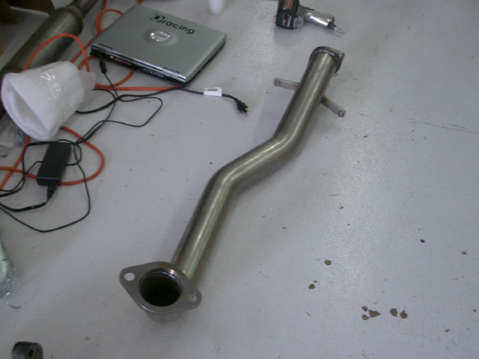

Posts: 1,907
Here is RMR DP
