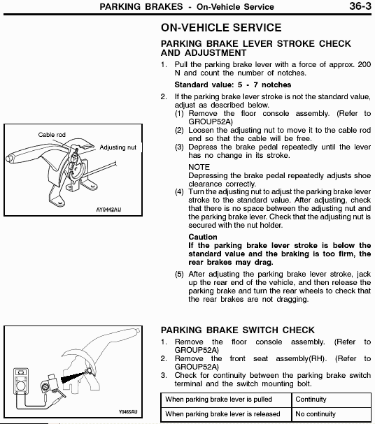

Your ebrake cable needs adjusting. Here is how to do it.
Do a search on how to remove the center console..

Some come from the factory with this thing not adjusted properly.. if you are not comfortable with doing it yourself, then take it to your dealer. It should be able to hold your car on a 20* Incline!

jemm thanks for throwing that up. I recently adjusted mine when I swapped out the ebrake handle for a stock unit. It's got much better feel to it now. DO NOT forget to check for dragging as the instructions say!

If you haven't already, pick up (or download, google it up) a copy of the evo viii tech cd.
