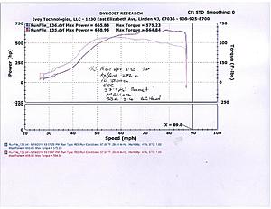

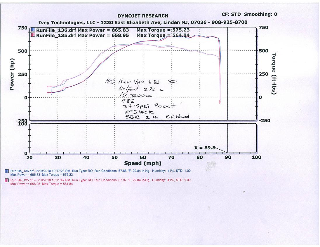

Ok back on the dyno with Scott's car.
HKS VPRO, 3.30 VER, Iveytune "spl" data :-)
Kelford 272 Cams
BR head
SBR 2.4
All nicely painted, this car is very well kept :-)
This is what we have so far on e85.
WG actuator needs to be adjusted wont hold or make much boost.
Sean

GREAT WORK! Always love it when someone gets a block and really makes something great happen with it!!!

Damn Sean.. Making me sweat.. My FP BLACK Record in Danger of being taken..
VERY VERY NICE RELIABLE POWER you made there!!!

what will this do on pump 30 psi? phenomenal numbers, truly pushing the black and showing it can go 600 plus easily

Great numbers as usual Mr Sean.

Great looking numbers sean. Glad I bought this turbo. Wish we had some E85 here in town......
