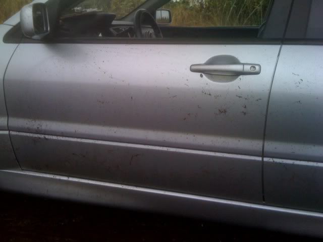

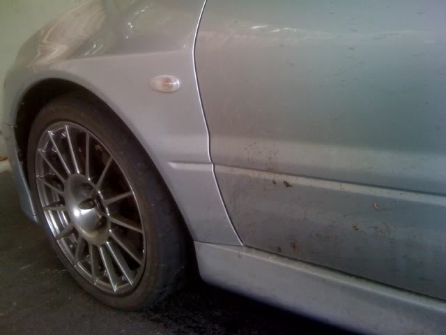

I had a chance to get to autox this weekend in the rain with the TRE diff for the first time. It was very interesting, alot of oversteer available quite easily. It also allowed me to race with the rain setting on the acd race flash, where I just pretty much left it at that setting all day. Before the rear diff I would get understeer from losing traction on the front tires due to the rain, but now the diff seemed to help 'kick out' the rear so I can throttle around the slaloms a bit. This techniqued worked well but it was very easy to go in too hot around a cone and spin out. I dont know how much of a difference the acd flash and diff did my themselves, as the last time I autoxed in the rain I was on a completely different setup. I did notice that if you paid attention it was easy to read the cars behavior at its limit right before the rear would totally lose it. Going top of 2nd gear around a slalom got the rear squirrely and I did manage to spin out onto the grass. I dropped tire pressures that day to 34 psi rears and 35 fronts, I wanted to try rear pressures lower cause it was still very loose in the rear. I think its just cause I do need a front swaybar and could definately use some coilovers at this point. My robispec springs have been awesome so far though.
Here are some pics of the evo getting dirty, this was after I cleaned it up before I ran out again.
I was so happy to see I didnt break anything when I spun out. I slid into some trees and luckily stopped a few feet from some redwoods.lol
